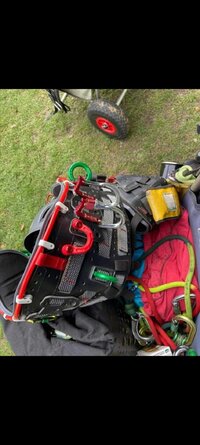

Ha! Yeeeeha. The zip ties just hold it in place, I have a carabiner through it too but it’s a screw gate and do want to get around to see if a screw link could fit. It’s the old Mumford adjustable bridge with a little bit of a spin. Nothin fancy, it’s backed up, and the roll’n’lock acts as a mechanical knot block.
You can kinda make out what I have going on. There is an older pear hms petzl screw gate through the eye of the roll’n’lock and through the outside of the suspension webbing.
The tail of the adjustable bridge is just looped through a gear carabiner to keep the tail tidy and out of the way. It’s not tied off to anything and has a stopper knot.
As I said it’s simply just an adjustable backup bridge and really is only load bearing when I suck it in.IMG_2479.jpeg
As I said it’s simply just an adjustable backup bridge and really is only load bearing when I suck it in.View attachment 92450
I also have one bridge a hair shorter than the other for redundancy, and would employ my adjustable in a similar way. I like how your setup keeps the adjuster on the outside of the bridge area, and am strongly leaning towards that setup for that reason. Thanks.
