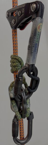

In yet another RRV thread derail (sorry) - been playing with the Arbesession hitch and the Arbsession Caralink V2 tether - I gotta say this thing is pretty much the sweetest hitch rig I've ever used. Pics show 26" Donaghys Armor-Prus 8mm Sewn Eye to Eye on 11.5 mm Tachyon - it's basically Arbsession's Kit 5 with the 8 1/2 inch tether and the ArbSession Hitch. One thing I would do after reading Patrick's posts above is substitute the DMM triple locking PerfectO that comes with the kit for a DMM PerfectO with a closure DMM calls KwickLock - twist and open. This has a little bigger gate than the straight gate PerfectO and maybe doesn't flop around as much (for me anyway). Casey said he'll carry these if you want to order one so you can take the tether off and switch to moving rope just as easily as the straight gate. I also used Aquaseal (can't seem to stay away from the stuff) to stiffen up the Caralink tether to PerfectO connection (you can see this in the pic below). With couple of coats of 'flexible' polyurethane, the whole tether became essentially rigid. Cats meow this is. Cheers all
I had issues with the Arbsession hitch and have gone to the Catalyon instead. More reliable engagement.

The Catalyon is a mirror image of an Arbsession Hitch, that’s been rotated 180 degrees. Tying an Arbsession and taking the eyes to the back will give the same results.
Extending the Arbsession’s lower section 2 or 3 more times creates enough friction for it to be used on a fixed rope alone, like the Sticht. It self tends, especially if tied snuggly.
The above is very similar to the Synergy X, someone has done the same with the Michoacán, called the WLR, and I’ve come up with a couple variations. I call them Series hitches, hard to equalize the eye length, tying a stopper in back is the easy way to go.
