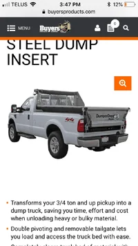

I’m in the process of getting my business started and just looking for a little advice. I should add that I have a full time job and that this is going to be a side company until I’m capable of taking it full time. I’m going to be operating as a 1-3 man crew with my girlfriend being my primary helper and jobs that are bigger I have a buddy or two with some experience.
Anyhow, I’m tossing around a few ideas for equipment I feel would be benifitial to begin with.
Option 1: Is to install a dump insert from dumperdogg and turn it into a chipper box onto my GMC 2500HD and purchase a vermeer BC900XL. I see the benefits of this set up being the ability to chip brush and minimalizing trips to dump but I’m also seeing negatives of gear storage and feel as most clients will be looking to have the stumps dealt with.
Option 2: Is to purchase a Vermeer SC40TX stump grinder and a Vermeer S925TX mini skid along with a 14’ dump trailer so I could be taking both units to a site together in the trailer. Positives I’m seeing with this is easier on the body having the equipment to manage the heavy stuff as well as grinder on the truck to complete a job. Also the fact that the bed of the truck would be empty for gear.
Option 3: is of course taking the rental route. Although I went to all our rental stores today and just don’t see how you’d be achieving a lot having to pay the rates that they have set as well as 6” chipper is the max they carry and mini skids only have forks available.
Anyways, hopefully you folks are able to give a bit of advise or any other recomendations if possible. Thanks you all for your time, Erik.

Thank you fellas, What I’m taking from your comments is that the chipper route is probably the best to get started with? Do you see any draw backs to the dump insert being too small? A designated chip truck isn’t really in the picture right now.

I rolled with a 3/4 ton, aluminum dump insert, and a 2,700lbs 9”. I out grew it pretty quick! I looked pretty hard at dumper dawgs. There is a sub frame with a scissor hoist so you loose a bunch of room. Also the steel units are pretty heavy empty! I found one custom fabbed by some farmer in Canada. Dual rams on the side, very smartly built and only sits 4” off the bed. It’s bolt pattern is the same as the bed of the truck, so pull 4 bolts and replace with slightly longer. I’m not sure if the weight, but I can manage to take it in and out of the truck solo. Guessing the dump bed - rams and pump is about 400-500 lbs?
