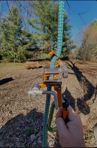

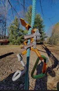

As for the uni, I don't have any off the shelf mods on mine, but I did make a captive bar with bearing rollers for tending slack. I'll look for a pic. I can't remember the last time I did much repelling in doubled rope on it but I seem to remember it being smoother in srt for descents

Is that captive bar aluminum or steel? Suspect aluminum might not bend nicely. Have a vague recollection of seeing your mod back in the day. You could say I was greener to the game back then. The skateboard bearings twigs a memory.
Yes, I posted those pictures back in 2020. I actually found that old post to screenshot and reshare them verses finding them on my phone.
It is an aluminum rod, I picked it up from a Rural King. Bent it with a hammer and a vice.
Two negatives to the mod. You do have to cut off a portion of the factory bar, this makes room for the bearings. If your ok with tending on the stock bar you could probably modify my design some to keep it in tackt apart from drilling and tapping.
2nd negative, this design does get rid of a nice feature of the Uni, which is being able to go on and off the rope without taking the Uni off of your bridge. A work around to prevent dropping it. Open remove from the bridge. Swing the captive bar open and reattach to the bridge. Remove the rope like normal.
To shave down weight get someone to machine a teflon or delrinAF pulley, maybe with rope groove, to replace the steel bearings.
