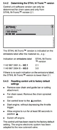

To answer my own thread:
Including the text for future search-ability.
5.4.2 Determining the STIHL M-Tronic™ version
Control unit software version can only be
determined for chain saws and only from
STIHL M-Tronic™ version 2.1.
The STIHL M-Tronic™ version is indicated on the
emissions label after the material no., e.g.:
If there is no such indication on the emissions label,
the STIHL M-Tronic™ version is lower than 2.1.
5.4.3 Resetting control unit to factory default
settings
S Remove saw chain and guide bar or cutting
attachment.
S For chain saws: Remove the chain sprocket
cover.
S Set control lever to the }position.
S Start engine, without depressing the throttle
trigger.
S Allow engine to run for at least 90 seconds in
position }.
S Switch off engine.
The control unit has been reset to the factory default
setting. The engine electronic system has been
adapted to the new solenoid valve.

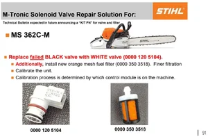

@samsquatch I just called Stihl and wanted to clarify a few things with them. Here's what they said.
1) The 90 second reset procedure for V2 puts everything back at factory settings, but the saw is not calibrated to environmental conditions at this point. You still have to do the 5 uniform cuts before saw optimizes itself. The V3 version uses the 30/30 reset, but you still have to do the 5 uniform cuts to optimize saw to conditions.
2) The black solenoid is what came on the V2, the white solenoid came on V3. On the 362 you can pair a white V3 solenoid with a V2 coil and it will work fine. You cannot pair a V3 coil with a black V2 solenoid - you will have run issues. On the 661, you can pair a white V3 solenoid with a V2 coil and it will run fine, but Stihl is requiring that the coil be upgraded to V3 to meet EPA. The problem with the V2 solenoid was the use a plastic disc along with a metal disc - the plastic disc was wearing out prematurely and causing a rich condition at low rpms. V3 solenoid uses two metal discs.

@samsquatch What is the part number on your coil? it will be a 470x number. If you are V2 saw with black solenoid, it should be a 4701A. If it says 4702, 4703, or 4704, then that is a V3 coil and you will need the white solenoid. Don't mean to beat a dead horse, but you got to rule it out seeing someone else had saw ... and coil could still be defective or another problem altogether.
