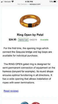

It's exactly like the Ring Open @Brocky put up there - allen key, little segment that crossbolt goes through, threaded on one end, rubber washer on other to help prevent back-out of the bolt.
I was complaining about the difficulty of removing all that in the tree, versus unclipping a carabiner, threading splice through ring, reclipping carabiner.
