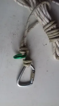

Does anyone see a safety concern using knots to try out the concept? I was using this rope in some small trees yesterday, and I kept changing between the steel biner and a quickie for cinching smaller stuff. I was also using my lanyard chinched with a regular biner, using the akimbo as an adjuster.
In the picture the ring is threaded on the standing end of the rope.20200217_150547(0).webp

Looks good, love it. Great way to explore the concept. Steel biners scare me on the end of a line, but I know you'll be careful ;-)
-AJ
Using it the way you demonstrated but with a ring replacing the carabiner in the soft tight eye.
Might add some additional versatility to the setup.
You could space the rings out a little more which might give the ability to cinch up on smaller diameter limbs.
Just some thoughts.
Aha, I see, I get it. the main problem for me with two rings is losing the abillity to have quick carabiner functionality in the mix so I don't loose normal options I expect to have.
-AJ
A rope optimized for (but not entirely married to) a texas tug anchor is pretty genius by itself. That's very tidy and not floppy. Just slap a pinto on that carabinier and you can take a couple of redirects with it no problem.
I guess you have to switch your retrieval position to the end hole to smooth it out, too.
Edit: or not. I really need one of these to play with to figure these things out.
Turns out with the Pinto on the end eye the pulley sheave doesn't get to take on the full bend in the rope to help pulling out a redirect. The shackle takes most of the bend. I simply flipped positions, now the Pinto takes all the bend. The shackle in the end position is a backup to the Pinto that probably isn't needed. Pull down is attached to the carabiner.
It's not a huge advantage to what's currently done as far as I can tell except it is knotless so a hair quicker to implement and nothing is midline attached so a little quicker to reconfigure if you decide to change anchor or system modes in the tree.
Pulling it out against a redirect, the shackle doesn't interfere with the Pinto doing its job.

Can't say what I'll think about it yet, haven't tried it yet. Will be working the next few days, so I won't be able to try it either. I really need to find some more thin stuff to try it on.
