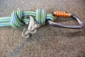

Moss Cinching Lanyard prototype
This is what I did...
The ring Reed and I use is one of the smaller, maybe the smallest ring dmm makes. Put your lanyard through the ring and slide the ring down and over the top wraps of the Mohican so that when your not using the ring for choke it will sit in the space above the bottom wrap of the hitch. If you use a 4over 1 then the ring sits below the 4 and above the bottom 1.
If you would just look back at Reed's posts I think he took pictures and everything.
Haha I saw it say before yesterday or whenever it was first linked, but man I'm literally not seeing how he doesn't have to unclip a carabiner every time he wants to cinch. If I had a carabiner on the end of my lanyard instead of the eashook, easy peasy, I get it. I'll take another look in the morning and see if there's something obvious I'm missing here...
Ahh I see what your saying. Yes ditch the snap so you can just unclip the biner, slide the ring up over and off the hitch and slide the splice through and reclip the biner o to the eye. It will choke tight on any diameter I've tried and where I think it shines Best is when you want to remove it...it's fast slick efficient. Worth a try. If ya don't like it theres so many other ways to do this.
Man I'm glad I'm not crazy! xD
Cool I'ma mess around with this.
Put a bight of rope from below snap through the ring and clip the snap to it, pull the slack out?
oooooOOOOoooo that's nice! I'll have to play with that as well and see how it dooooo. Man, y'all that come up with this stuff have beautiful minds. I'd never think of half of this.

I made a knotted version using a Quickie shackle this morning and it seems to work fine. Probably not as smooth as your version with the round shackle, but definitely good enough to experiment with.
Definitely knot as pretty as the sewn version, but it works. I just stole Climbstihl's idea and ran with it.
Arlo, send me that Quickie and I'll send you back a slic pin bow shackle! And a sadly empty Quickie ;-) Just a heads up, a small detail... you're all sworn to secrecy lest Weaver or Notch product development is spying on this highly sensitive secret discussion... I put shrink tubing on the two sides of the second eye that holds the shackle. I noticed pretty quickly that taking the slic pin in and out when it is going through the eye (what I usually do with the bow shackle) picks rope strands.
The way you have the Quickie set up is perfect for a remotely cinched/removable anchor and clearly does not require shrink tube protection on the eye.

Plan is, (and I know everything takes too long), to have some sewed up and pull tested in a few configurations then make them available if everything tests copasetic. I'm currently about to test 11mm vs. 11.6mm with the bow shackle to see which is better. The 11.7 Arrow Frog I'm currently using tends to jam a little in the throat of the bow shackle when used in "standard" cinch mode (not the retrievable/remotely installable mode). It's not a show stopper but if it works better with an 11mm line then that's what I'll go with for a production run.
