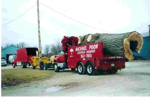

my experience with using the eyes on the lower boom to make a heavy lift is that the jib gets in the way unless you use longer slings. this does come in handy for lg. logs. that might otherwise be too heavy for some jibs. hey mark chisholm congrat's on your climbing in minn.!!!
hey gus, welcome! in your 1st post you said there was one trunk pick w/ jib that concerned you. were you talking about the silver maple? that pick was 800lbs. below the max. for my jib. my old crane had quick connects on the jib and every time a piece of brush bumped them they leaked! the 1st thing i did with my newer crane was take the quick connects off. i'm trying to decide how much the hoseguides for the end of my jib would get tangled in brush. let me know what you think.

Thanks for the welcome Mike.
I wasn't sure of the weight of your pick and it's hard to eyeball a lift by just looking at a picture. If you were 800lbs below the chart then for the most part you're safe. The one thing with all flyjibs regardless of manufacturer is that there tends to be slop/play side to side where the jib connects to the end of the main boom when slewing and stopping suddenly. Even if you are below the chart and make a sudden movement the risk of bending or breaking the jib is very probable if you have the Jib in a full vertical position. As long as you take your time and move VERY slow with heavy loads this will never happen and being as it is your crane I'm sure you take extra care....unfortunately some operators rush and that's normally when you run into problems. A different industry that is very hard on cranes and flyjibs is the poured wall or foundation industry where there is constant side to side movement and the guys are rushing to get to the next hole since many are on piecework.
