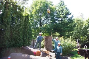

here is the trunk being picked. (sure would've been nice to have that out the way, but didn't slow us down anyway)

in my last post i forgot to type in the word car (next to the outrigger in photo) sorry. hey m.b., i set slings low to make it easier to lay down in the truck bed (but only when i'm sure it won't flip over eg. decay below & solid above)hey allmark, how's crane shopping going! i figured the log weight about 7400 lbs. hey norm, your pal mike dirksen came by a job (elm removal) a couple weeks ago & took some photos. it was cool to see him there. (dozens of arborists from out of town tell me they're going to come check out the crane, but dirksen is the first to check out the newer/3yr. old crane) we did alot more talking than working! which was a nice break.

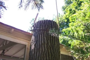

Here's a question I'd like to ask the gang; What do you do when you have to pick short hunks of wood due to weight constrictions?
The reason I ask is I am wondering how you all deal with having to pick from a max radius and you'd like to ensure that there is no tip over of the log.
I have a 44" cottonwood to remove between a couple of summer homes that will require some 4' logs to be picked off. Some have told me that they used tongs in this case. What do you do?
Myself, I use two chains with locking hooks. set them opposite sides of the log, and cut deep (6") notches in the top of the log to sit them in. That way, I get no tipping, and if you tension them first, the chains will 'bite' into the wood far better than a sling.
Have used tongs for lifting off the ground, but not for lifting out of a tree. They seem to work well, and I'd trust them 95% of the time.....
Long Amsteel slings, not that I've done it lots, but I'd running bowline low, with a Marl above c of g, with the dead eye in the hook/shackle. 2 slings, 180 degrees opposed.
Only an idea from a guy who plays with big cranes at most half a dozen times a year.

hey norm, isn't that the "norm hall self leveling rig" that you showed us a few yrs. ago? that's one of the coolest set-ups i've ever seen! hey mark chisholm, i would think norms rig would be the ticket for short wood. what do ya' think? ( i usually just use 2 polyester round slings set high & wedged in notches, if i had more steelchockers i'd try norm's rig.)

That's the 1. Have used it many a time for strate lifts.
Mark, the largest tongs I have found for overhead lifting only opened to 24". The larger tongs say "Not for overhead lifting. For skidding purposes only".
