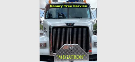

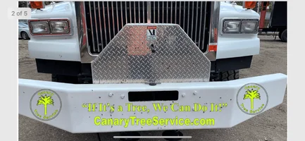

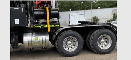

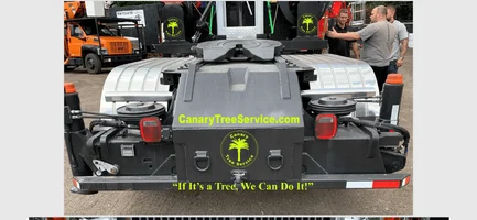

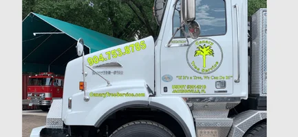

Is this like the Palifinger as far as the using a electronic controlled diverter valve to switch from a jib function to a grapple saw function? I know this is how it done in the past, wasn't sure if they changed that or not.
