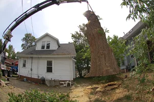

more fun with knucklebooms
The bottom piece was ~14k, the top was ~26k. I remembered because the crane was good for ~26klbs and the pieces totaled 40klbs.
The crane operator was wanting me to cut it in one piece! He musta been tired, it was around 830pm when we cut the next to last piece.
I should have taken the log on the left off in the first pic, but such is life.
