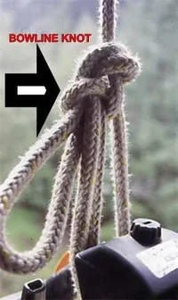

When I pull up my small tree chain saw I like to attach the saw from the top handle. It pulls over and around limbs with very little trouble. The Bowline knot is easy to untie after I attach my saw lanyard to my saddle.
Nothing worse than having the new guy tie the saw to the end of the lanyard so you have to untie the rope before you clip the saw on. That usaully happens only once.
