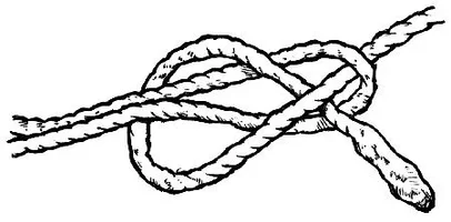

Here is an image of the traditional sheet bend used to attach climbing lines. This is a good knot but takes a bit longer than others for the climber to untie.
