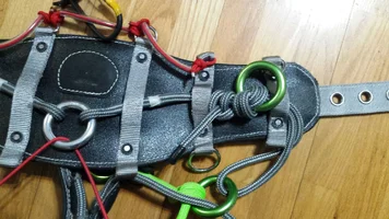

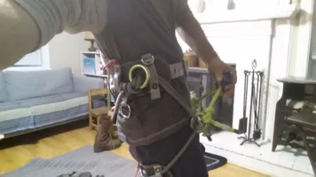

Thank you everyone for the quick replies. I think I found the adjustment for transferring support to the thighs and preventing the ball-crushing hazard. I regret having earlier cut the tails on the grey ropes that terminate in the unpainted ring in the back (but the tails were nearly dragging on the ground when I received the harness). I've terminated them near the side rings instead and it feels like it'll work much better now.mcrs retie.webp mcrs lowered.webp

Nish, on that last picture the position of your waist belt looks too high and the side loops going to the bridge rings too long. Your leg pads look right, just maybe bring the upper stuff down a little. If the waist belt is off the hard points of your hip bones you will not be able to keep it from sliding up.
Thanks DSMc. I probably over-corrected, but I was pleased to see how the rope bridge suspension point and leg straps could be effectively lowered just by lengthening those side loops. With enough rope I could probably turn those thigh straps into foot straps.
