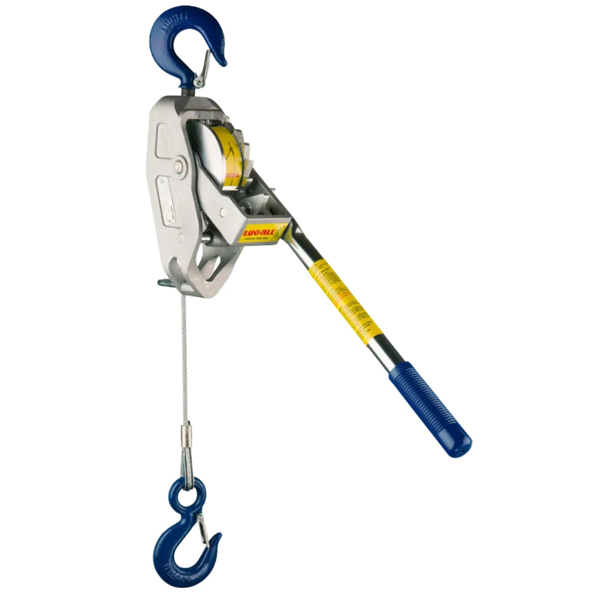

I didn't like using it and bought a Lug All cable come along. This has performed flawlessly for years. I've had to have a new thimble swaged onto the end a couple of times. It can be rigged 2:1 too
