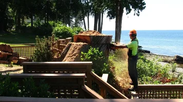

Almost done...

Do you have a close up of the floating rigging point?
How easy is it to use the gas powered winch?
Who makes the shirts, mine get trashed in the stomach in safety green?
Great job!
Great to finally see how that awesome job went, Gord! Thanks! Great work!
I can see why you dropped those sections, then yarded them up and out with the winch. prolly a lot easier that rigging them aloft and dealing with shock loading of the stem as they speedlined out.
too bad a big beach bonfire wasn't in the cards, eh?!
Was the zipline fixed and the rigging point connected to the port a wrap>
Yup that's right. As the winch raised the wood, slack was given to the rigging point via the portawrap and the wood ran down the zipline.
