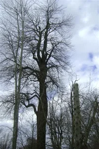

Attached pic is of a 5 ft. dbh Cotttonwood. The red lines represent proposed reduction cuts.
[/ QUOTE ]It looks like the 3 main leaders are getting cut back to the same predetermined level. if branches are the concern, why is the top getting cut back so hard? This could be called topping, even if the cuts are made to nodes, because it does not regard structure and health. Quick rot and crazy sprouting would seem inevitable.
Yellow dots at proposed cuts, 40 or more, <2". Handsaw and pole pruner, i'd take ~2-4 hrs in tree; why rush, when it takes time to read the tree and do it right? Re-prune when sprouting slows down, 5 year cycle?
Orange line point to stub--is this the branch that broke? If so that shows that tip reduction like the yellow locations should be adequate to mitigate that risk to a reasonable level.

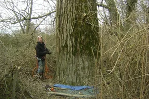

I thinned/deadwooded on my way down - out of admiration of the size of this tree. Got to the ground and had a cigarrete(see attached).

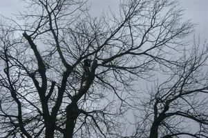

Got the throwline up 60 feet. Installed the XTC line.
Ascend, then set 180ft HiVee line once with 20 ft polesaw.
Make way to t.i.p about 150ft up. I think the tree was 180ft total.
This is the first of the three limbs cut. 2 behind me also got cut. Limb on left is what blew out in storm 3 weeks ago.
