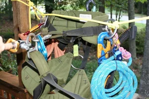

Here's how I've been stowing my lanyard for the last couple of months. 16-18' total length, small eyesplice at both ends. I leave a comfortable length immediately usable and daisy chain the rest. When more length is required, I unclip the daisy and "peel off" what's needed. Nothing new there, just wanna start a thread to generate some ideas.
