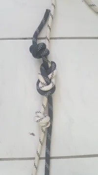

Had to look up the Zeppelin bend. Thought it was the same as the Hunter's but the copy specifically says it is not. I'm a big fan of the Hunter's and would use it for life support without any worry. Learned the Yosemite bowline from Jepson, always breakable even when loaded heavy, fantastic for so many applications. For heavier rigging the bowline on a bight can be easily undone after insane tension, but that's a bulky one in your situation. I would also consider a Carrick bend if the tension remains constant once set. Bends like Carrick and sheet bend hold up okay if taut but if they're slacked and shaken they slip. Gonna try the double sheet-bend with dbl barrel tie-offs, I've never tied it that way, haven't tied sheet bends in awhile.

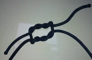

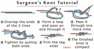

Kind of off-topic I know, but the surgeon's bend, as a rigging bend the way I learned it (pic called SurgeonsBend) is excellent for being breakable after heavy loading. I learned it as right over left, twist both ends in opposite directions 360* until 4 intersections are formed. Then switch order and do left over right, repeat, twist both ends simultaneously 360* in opposite rotation, forming another balancing 4 intersections. Then set tightly and balanced.
Not to say that it's unsuitable for life support, but it needs to be set very carefully in critical applications. The pic called "SurgeonsKnot" is not what I learned from Morrow, but I'd use it for utility connections cause it's super fast. Same idea when tied on a bight is a surgeon's loop. Pic called Step4 is yet another variation.

I recently had to tie two ropes together because the tree I was in was just a bit too large, I used the zeppelin bend and then tied off the ends with double fisherman's to back em up, worked great! Of course I didn't sinch the double fisherman's super tight so they could be Un done easily.
