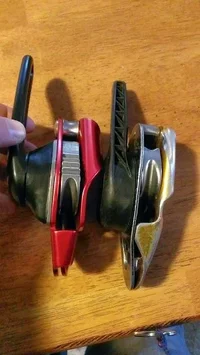

Got the D4.this week and just got a chance to get on it on my tripod. A lot of control with the speed and solid build. Design wise I like it more then the RIG (I have been using the RIG only for close to two years now). It is heavier then the RIG but that's not really an issue due to I hang on the D4 and not the other way around.I will get some vid of me flying it up this week and also doing some rigging as well. The one handing is sweet!

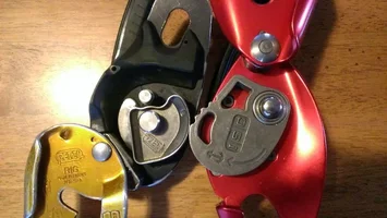

Some good fly time on it today. I have the feel for it down now and can get around the canopy as if I was on a hitch. Takes time to get the feel for it though and the panic feature can make you nuts, but once you get the muscle memory down it's smooth. If you have climbed on the RIG for any amount of time you will notice right away the control difference. The cam in the D4 is noticably larger and the V cut in it is deeper then the RIG.

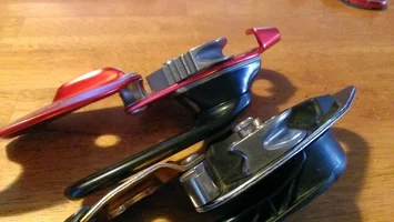

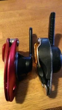

Some more observations I have made while getting more climbing time in with the D4. The cam action is in my mind an advancement to what Petzl has with the RIG ( I don't want to compare it to the I'D, because I feel the I'D is more for the climber that is just starting and the RIG/D4 are for more advanced or seasoned climbers).
The D4's cam action allows for a climber to suddenly let go while descending and reach out with both hands for something without the worry of having the cam open in a free running position like the RIG is notorious for. For me in tree work and also industrial (more tree side due to industrial guys having a MI every time I take the slightest swing)this is big because it allows me to swing and descend or jump out and down while still reaching out with a free hand to catch a lead or branch, all while having the comfort of knowing if I let go all the way im going to be locked up.
I will post some pics that are close up of the RIG and D4 so guys looking at it to possibly pick up can get a better look.
