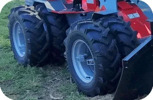

The Baby Giant 254 only AL with Factory authorized Duals. one badass forwarder

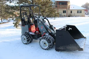

1) I bought my GIANT loader from Top Notch Equipment in Minnesota, but now @tnttree sells them. My original loader has a "euro" plate I believe they call it, so I bought a Bobcat adapter plate and had my BMG made with a Bobcat plate, that way it can attach to our skid steer as well. In that process I learned there is a difference between Bobcat and Universal plates, but I'm glad I have the Bobcat one. Branch Manager has been fantastic to deal with as far as customer service goes and GIANT is far superior to any of the competition in my opinion. I have 2000 hours on my machine in just over 2 years and the only issues I've had is a throttle cable breaking and just recently my ground cable broke.
2) I use mine to plow out yards every day in central WI.
3) Traction isn't an issue, depending on depth of snow. They have low ground clearnace, so obviously if you have deep snow it will not glide on top of the snow like a tracked machine will. You just have to plow your way into wherever you're going.
4) No idea.
In my opinion, an articulating machine is the way to go if you're always doing residential tree work, they leave no trace!
Photo 1: You can see the Bobcat plate that's on there.
Photo 2: Lifting capacity
