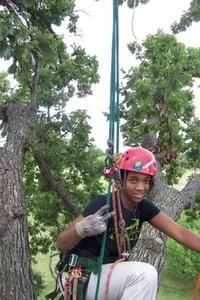

This is a fun little rig I have been playing around with for the past couple of months. Its a blast. I used it in the Ariel rescue event in St. Louis. Its pretty straight forward.
Take the hitch climber and set up a normal hitch like you would normaly do. Use a sure catching hitch. Instead of clippin it into your harness, Clip it into a big pulley.
Take a shank of rope, put it though the pulley and run the loop down into another hitch climber, thus you have a three to one. Pull the pulley all the way up into the tree as high as it will go and clip into the htich climber with a bridge. Use a micro pulley and a sure catching hitch to control you line. climb like you normally do but with three to one. check out the pictures.

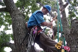

i didnt catch the pulleu but its there. here is the way I rig my bottom part of the three to one.

This is fun to play around with. It is only retrievable if you put it on an SRT system. Or you put a pulley and throwline above the top HC. To crazy I think. It is not dangerous if the top pulley slips, it is a circular system, you just dont go anywhere.
you can also use another line to pull the top HC up the rope. this can be cool because you can pull the top HC part way up the tree and then pantin or footlock it while you are cranking the 3:1 with your arms. cool sensation. This system is not circular so it is crucial the top HC is holding.

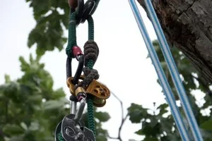

When you feel like it, you can bail on your sytem tied below. Or you can switch into the top HC and come straight down the line. here is a pic of it pulled to the top.

In St louis, i ran it up using the access line provided. Using three ropes actually works better than just. but you need a third rope. In st louis, it incorporated 3 ropes, 3 hitch climbers, three prussics, i dont know how many biners, and three pulleys not hitch climbers. I used another pulley on the bottom to run my harness system through, it didnt work out that great, it also puts you a little too far from the system. DMM biners dont fit the HC sadly. You can run a second biner off of the bottom HC. Then run dDRT system from your harness through two biners instead of just one, this provides a little better bend radius.
