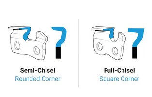

That's the setup I have and am pretty happy with, but it's not a true full-chisel chain. It is a lot closer to a full-chisel than some of the very round corner semi-chisel out there, pretty close in fact, but doesn't have a true 90* edge. Semi is a little more user friendly and forgiving and maybe full is too aggressive for the saw since it isn't super powerful, I'm not sure.
Here is the Oregon I run on the T540i compared to the Stihl full-chisel I run on my 200T for example.
We named full chisel " number seven"
