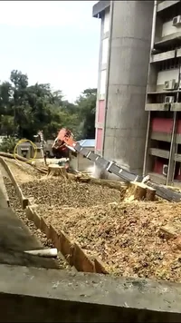

How could anyone think this is a good idea?

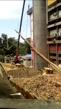

Do you guys remember that video from japan? Taking down a big redwood type of tree at a temple, climber was wearing unusual spurs. They appeared to have small spikes on his heels and he leaned back into his flip line and moved around quite nimbly. They had a couple of cranes there and I couldn’t tell if the one down the hill was being used to pull the logs off the stem, but some kind of serious pull was being applied. His cutting technique was odd too but what I’m getting at is perhaps this is an accepted practice there? And our circus clown just cut too much holding wood with his dull saw and botched the plan? @SoftBankHawks ?
Yep. That’s the one. Thanks Nic, can you tell if the crane that is visible when the trunk is going over is involved in the pulling? With a redirect? I’ve just got an iPhone and can’t really tell. I’ve got the same problem with the original vid I posted, can’t really make out the rigging,,

Crane should be Pure Inline overhead lift only; no impacts.
i have done the low re-direct of this force to pull tree over; so is pull up by crane to make stronger hinge on final drop; but no falling impact caught by crane like @~6mins. temple film.
