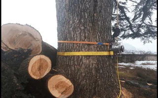

Good morning to all, have you never used the ATD winch and lowering device? I've used GRCS but i've changed..... since about 6 month i'm using the ATD and i'm very happy for the change.... I premise that i'm an arborist and not faller. The stopper is beautiful and the all in one winch-bollard is a must.... After 5 month i've understand that the device have a big and i've bought the second stopper for work with a second rigging rope.....(was an optinals) meanwhile the ground mans are processing the piece i can work and prepare the next piece.... so when i finish to prepare, the grounds man have finished to process the previous piece we are already ready for the next and so on. I don't remember but the WLL must be about 2.000 kilograms..... You can low with no wrap on bollard otherwise a quarter, half, three quarter, one wrap, and for every wrap you can choose quarter half or tree quarter..... The bollard is very thick and dissipate a lot the force very smooth helping a lot the ground man choosing the right wrap for the piece that are cutting. In this way is very easy to "drive" and control the fall. The stopper is very nice and helpful. I'll be happy have your opinion.
Have you guys seen that old vid of Ken Johnson purposely destroying a GRCS droppin an old wrecked Volvo suspended from a euc to find its limits, springs n hardware explodin left n right. Then does the same with a Hobb's n just bent the fairlead a little!
