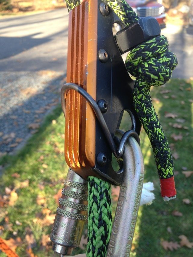

On the tending straps, for improving the Hitch Hiker in a walker/frog type ascent, care needs to be taken that the material and length do not interfere with the normal function. With small diameter material pulling at the awkward angles where the carabiner meets the body of the HH, it is easy to get some jamming into the slots. But most important is that the tether not be long enough to catch the upper part of the HH and in doing so preventing the carabiner from doing its job. I am finding 5 1/2" to 6" eye-to-eye length works for me.
So far, I have had the best luck with stiff, flat, leather-like material.

thanks for posting my vid Nick. the coathanger has banged up the aluminium a bit, but a lot of that was from me bending and fooling with it while it was in place. i am going to try a stiffened cord, maybe insert the hanger into a piece of parachute cord. i would love to see V2 incorporate a connection point for drt, but like a few said, it isnt necessary.
Moss, The coat hanger seems to have beat Jamie's HH up pretty badly. A piece of throwline will work into the slots fouling the HH function. I used a piece of 5mm cord with the ends taped into tight eyes.
I originally tried some mechanics wire like Jamie did with the coat hanger, but the cord is a better solution IMO.

This works really well. It is cut from a 1/8" piece of extremely tough polyurethane from a horse hoof pad.
David
That looks good, David. Is there any chance the 'strap' could get caught in the lower slot and prevent the 'biner from grabbing the rope?
No,Jack. This poly stuff has just the right combination stiffness and flexibility. Also the section that the carabiner goes through is 1 1/4" wide and somewhat slick on the inside so it slides well on the HH side plates.
David
Looking good as usual, Dave. Figures I made a stainless trap for my HH this morning and I come in to find this post!

I'm on my phone so hopefully this picture isn't too big. If it is I'll resize when I get to a comp. My clip is just like Jamie's just stainless so it's pretty ridged. I think Dave's will treat the hh better cosmetically over time and doesn't run the risk of getting caught in the lower slot. I don't think mine will get caught but I am keeping and eye on it. It's really small and so far I like it.
