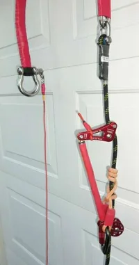

Oh, the small cordage? Sometimes I set two SRT lines from the ground just so I don't have to move anything. When I get up in the tree, I pull up a mini-DdRT system and work off of that. If I need the other SRT line, I have ground person clip my haul line to that cordage and I pull it up the rope to me. Lets me set everything up on the ground before I go up. I'm playing with the SRT for work positioning, but I like having my DdRT setup as the primary. Familiarity and confidence thing, I guess, until I'm more comfortable with the SRT stuff. The anchor/friction saver in the pic can be installed and retrieved from the ground with only 75' of climbing line. The 550 paracord in the background is the retrieval line. Costs about six dollars for 100' of it. I don't like the idea of using 150' or 200' of rope when 75' or 100' will get me where I'm going.
Now, I'm having the opposite problem. The 8mm EpiCORD is the only one that grabs every time, for me. At least on the 11.5mm and smaller ropes. The 9.3mm EpiCORD is working well on the 11.7mm and bigger ropes, though. Here's the 8mm on KM Max rope, which I believe is 11.2mm or thereabouts. This combo is working great for me with either a distel or knut hitch.
Gorgeous work on the friction saver and on the Rope Wrench tether, Jeff. I love the look of stainless steel, too.
