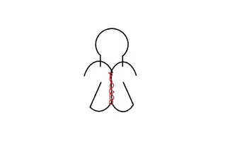

what about this for the captive eye, take a regular bow shackle, one of appropriate size, and in the two openings (the smooth one and threaded one) first thread the 2 biners through, so that they are oriented back to back, where they then can be welded. The trick i guess would be finding a shackle that isnt too big but would allow the body of a carabiner to pass through, maybe would need to be bored out a little to make it bigger... but this would let you have both biners oriented along the spines where they then can be welded together, and if you really wanna get fancy, throwing a swivel on the shackle before the whole rig would make the thing function like an omni block. I know from a structural point of view you wouldnt WANT the steel biners rubbing against the steel of the shackle, but it would be a quick mockup of what you wanna do, or what if you even did this, and spliced an eye from an I&I prussik on each carabiner, then its just a matter of setting the prussik on a rope or girthed to a limb, and you are free to climb from there. It can work with all steel hardware, as well as with textiles.carabiners and shackle.webp
In here you can see the two biners back to back, the red line just meaning they are welded as one unit, and above is a shackle, only qualm would be a shackle with eyes in it that will allow the diameter of a carabiner to pass through. and the orientation of the gates seem backwards, but thats just asthetics on what i drew up

And Steve, if I get around to welding one up, I would weld the captive eye at the same time I joined the biners. I just think if you are going to be welding anyway... But your suggestion is very clever and I like the way you think. Great stuff.
