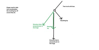

Musings on resulting lays.
All of this geometry plays very much into the needed angle of the guying line, or lines. The guy line support operates in an arc with the anchor point location determining the shape of this arc. The trunk and hinge act as a straight line being supported by a guy line offering 'support' that changes along this arc.
Is the anchor point perpendicular to the lean? Or perpendicular to the hinge?
Almost all arborist and fellers use intuition.
But it is all quite complicated.
