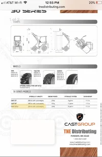

254TELE factory spec capacity
Why is the lifting capacity so different between the standard and telescoping 254? I understand the capacity would be lower when telescoped out, but I assume the lifting capacity would be rated with the telescope in?
I was wondering if the difference was a heavier arm because of the telescoping, but according to the specs the overall weight of the machine is the same... Although, it looks like they may have some numbers wrong, because according to that chart the lifting capacity is greater than the tipping capacity on the non-telescoping machine.
I should know - but I believe it is because of where the arm pins are located, yes the specs are different on different publications - the dutch couldn't translate well uniformly254Tbrush.webp
Yea when reviewing specs be sure to note how the numbers are generated. Different brands do it different, multione does there numbers with the weight 18" from the hinge pins i believe, and if i remember right avant does 16". A couple inches makes a big difference
