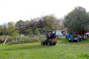

Thing about bigger more expensive heavier machines is you can only carry so much brush around a house, the little Giant can handle more brush in 1 load than most all tow-able chippers can take at once.

So the advantage of bigger machines is only when hauling logs out (yep a few less trips)
BUTT Again the little Giant can get the Job done
