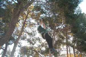

Thats a technique I'm not used to. I'll typically footlock to access the tree then set up a DbRT once in the tree. Are you working the tree with a SRT, Pancake? Or did you mean that you footlock on a single line?
Bodean,
Cool shots and tree! What part of the world are you working in?
Two points, if I may? One, those boots make it a little harder to footlock in with the heel space. And two, you really need to try to keep both hands under the prusik. Otherwise you might grab it out of habit and could result in a bad fall. Hope I am not insulting you with that. It's not my intention at all.
I work in San Francisco, CA.
No insult taken at all, with two very good points made by you.
I usually use my Vasque sundowners for the footlocking, though They were forgotten on that day.
As far as grabbing above the prusik, Thank you, that is a bad habit for sure,
I'll pay closer attention next time.
