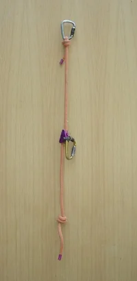

An adjustable tether (footlock cord) works great. Lengthen it for ascent, shorten it for rest or work. One handed adjustment, no extra locks needed.
Shown here with a carabiner that would attach to an ascender. I also have one with the Microcender placed on a prusik loop (so that a Prusik or Klemheist can be used), but no photo.
