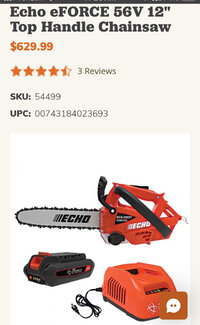

"Yah, $357 after tax/shipping. I don't understand why there are so many constantly on ebay, from different sellers even, around the $330 mark, when they are $550 at Home Depot and $430 on Amazon... At $350 for the package honestly it seems like a hell of a deal."
Maybe? lol
It's a fun idea, but it would have to be an absurdly detailed bootleg. The saw, battery charger, packaging, manual, accessories and all that are just as you'd expect from OEM material in terms of feel, performance, etc. I can't imagine a knock-off company going to that length without cutting obvious corners in other areas than a single little noise as the saw is deaccelerating. (the only time I hear it)
