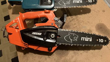

I somewhat often have jobs where I go up a sizable fir (or usually a few of them on waterfront properties) and take off like two limbs, just to make a peak through view to the water or mountains or whatever while maintaining overall tree/limb structure. I was doing one of those yesterday with my T540i, while thinking about this thread, and decided eh, why not give it a try. I'll use the stock bar/chain to begin with, but honestly will probably wind up doing the 1/4" pitch swap sooner rather than later.

Does anyone know why echo wouldn't have 1/4" pitch standard? I switched my 2500 to 1/4" right away because how much my 2511 improved going 1/4"; it was a totally different saw. Are there disadvantages with 1/4" I'm missing?
Tiny kerf, chains only good for a a couple filings, I personally wouldn't ever switch the stock chain on my 540ixp to 1/4 pitch. My msa161t has 1/4 and it's fine cuts well the saw wouldn't handle bigger chain so its the right choice for the saw.
I swapped my 2511 to 1/4 and also found it to be HUGE improvement. That said, I ran 1/4 on my T540i and found it worse than stock, though that saw has a good bit more power.
Some of the listings I've found for the 2500 mention .043 gauge instead of the .050, but none of them specifically mention being 1/4 pitch or not. I thought about calling one of those sellers to ask specifically, but at $550 for the set instead of the $330 on ebay, it would still be cheaper to buy the stock .050 and buy the conversion kit (which also comes with two chains) from Monkeybeaver....

I changed my 2500 to .043 gauge but left it 3/8 pitch. It may not be as smooth running as 1/4 pitch but I can live with that. I like the thinner kerf. The pitch to me is like what color your shoe laces are today. Doesn't matter to me. And it is way easier to find the type of chain I want to run.
It's interesting how out of touch it seems to be. I'd think engineering/ testing/sales would see the differences in performance and not want to handicap their products. I'd have to imagine any and all feedback from field testing with tree workers would be that 1/4" is better.
I bought the Echo pro series battery powerhead and got the pole saw attachment. It comes with the same bar and chain that the 2500 comes with and it sucks. The guy from UK chainsaw bars made me a custom 1/4” sprocket for it and I got the panther bar and chain. I’m going to make a youtube video of before and after the conversion to show the difference. 3/8” on this attachment might be fine for a homeowner thats OK with nasty pruning cuts, but not for professionals.

I'm not familiar with your piece of equipment. But I do have the 2500, and have been running it since before it was available in the US market. I am a professional and find it works perfectly fine with the 3/8 pitch.
This mania for 1/4 pitch is mostly bullshit. Makes the saw a bit smoother operating. On the other hand you will go through many more chains. And finding a professional chain is a pain in the ass, if you can find one.
But you youngsters can play with it and call it the next best thing to sliced bread. Make claims that Echo, Stihl and Husqvarna don't know what they are doing building saws with 3/8 pitch.
For me, 1/4 pitch is for the homeowner who has a 18 volt chainsaw on a stick with anti-kickback rakers, who uses it ten minutes once every five years.
