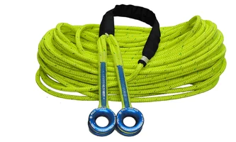

I keep meaning to try DRT one of these days. Meanwhile, any opinion on using this lowerable MRS false floating crotch as a floating anchor point for DRT? Thread a climbing line through the eyes, tie a midline blocking knot between the rings and maybe capture one leg with a biner. Haul it up to the desired union and base tie?

Yeah, for sure. But I'm talking Dual SRT. Using two legs of one rope for two SRT lines and using this setup as a floating TIP.
If you do that, a pair of alpine tied midline should be fine, one for each ring and you get 2 legs of rope to work off. Still only counts as one point of attachment though
Wouldn't one knot work? Just want to make sure I'm thinking straight.
Probably, but then there's no redundancy, and it might not load the rings evenly. So both ropes would need to follow the same path through the tree instead of having one redirected. Only way to know would be to try it
I guess that's what I'm wondering: does it matter if they're not loaded equally? Put all you weight into the line on the left, and the left ring is knot-blocked at the left ring from the center knot. Switch to the right, and the right ring is knot-blocked by the same knot.
I'm thinking that would work. Although possibly cleaner to tie your alpine in the middle and attach the loop of the knot to a delta link in the eye of your basal tie. I'd think that would retrieve easier than two large rings.
