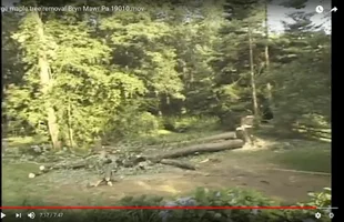

Go to 7:02-7:15...Curious why you didn't use the Huge, Massive, Ginormous lay of the Giant lawn, and instead drove your spar directly into a nearby tree? Can't wait to here your explanation Daniel?
Go to 7:02-7:15...Curious why you drove your spar directly into a nearby tree?

Fabrication and Truth...Really Daniel...We can all watch as your tree DOES IN FACT make a direct hit to the nearby tree (7:12), and it does so with enough force to break the backside top out of the tree you were falling.. You put the rest of this tree on that massive lawn Daniel, so why did you strangely choose to slammed your falling cut directing into a nearby tree. Planned, or some seriously piss poor shooting buddy? Either way, yet more fucking hackery on your part.....
You can call it whatever you wish Daniel (tree, spar, macaroni) but the piece that you fell did in fact slam directly into the nearby tree buddy (7:12), and it did so with enough force that it tore the top out of your tree/spar/macaroni..... Does that clarify the matter for you Daniel?
Now that you have just admitted to hitting the nearby tree, I again have to ask why would you do something like that when you had a few acres of open space just to the left?

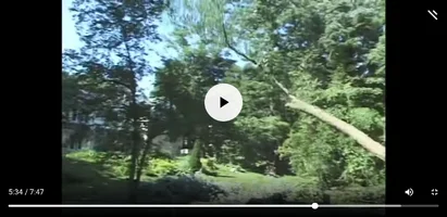

Look at the shorter spar with branch that got dropped at 5:30 and you'll see there was not a lot of Room in that yard
There was a well landscape area there with lots of expensive shrubs on that hill.

hardly wide open. this is the cut from 530, which was far shorter than the final drop.
It was a tight drop zone. that wasn't a straight stickScreenshot_20200325-165211_Chrome.jpg

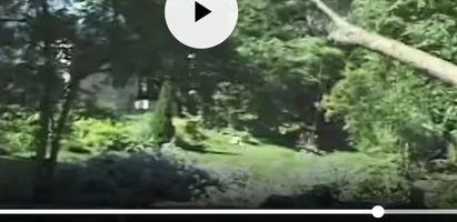

Pretty tough to talk your way around the truth, and 7:17 in your vid don't lie.. Lawn for DAYZ Daniel... So much for "camera angles", "expensive shrubs", and "not a lot of room in that yard"?
So once again I have to ask. Why drive your tree/spar directly into a nearby healthy mature tree when you had miles of open space just a few degrees to the left? We wont talk about what also looks like plenty of open ground to the right. Is this some super secret next level shit the rest of us are not aware of, or did you simply make a shitty cut?
So once again I have to ask. Why drive your tree/spar directly into a mature, healthy tree when you had miles of open space just a few degrees to the left? Is this some super secret next level shit the rest of us are not aware of, or did you simply make a shitty cut?
