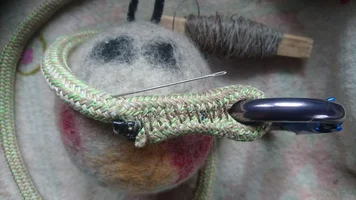

Documenting my hand-sewn eye process
Good point about the first zig zag pass. I forgot to comment on that, and the bonus of having a machine to do it!
Your seams are all much nicer than mine. I use 90kg fishing dyneema, and ordinary needle without lock stitches, and pliers. This is an i2i. In other applications I use a bit longer seam.
Three passes, the first gets hidden. Don't know how you guys get so dense stitching in there.
Feel free to slaughter it.
Visually doesn't inspire confidence ;-) Have you broken any to see how strong they are?
With a sewing awl it's relatively easy to get a dense stitch pattern.
-AJ
Thanks moss, appreciated - I agree. I'll order an awl and maybe thinner thread ASAP. It's just that one can't buy hardly anything this part of the world, and shipping a small package from the US for instance costs 40-80$ usually, from stores, plus tax and customs on top.
Will do some proof testing with mechanical advantage in the mean time, plus send one for break test, eventually.

In the Practical Sailor they mention that precompression does not increase the strength of a sewn eye. Previously I've used precompression on the advice of a tester who broke my first generation sewn eyes. Next time I make some eyes I'll try without precompression. I'm using stronger thread than I did for the tested eyes so that alone may make enough difference.
They also mention that polyester thread is superior to nylon. The reason being that nylon stretches and loosens the stitching. I often use nylon thread when I'm sewing 11 mm or greater cordage. I haven't seen any loosening of the stitching throughout the life of the eyes. It may be because I'm lock-stitching, for the Practical Sailer eyes they were not lock-stitching.
I've got some used 2nd generation method sewn eyes from retired ropes out for break testing. There are a variety of cordages involved, 10mm Globe 3000, polyester thread (retired after serving a long life as a harness bridge), 10mm Reep Schnur, nylon thread and 11mm Velocity sewn with nylon thread. It will be interesting to see how they all do.
