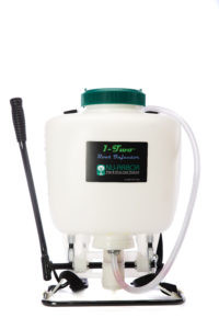

How heavy does the nu arbor end up being when weighed down? It'd be great for my guys, I'm a lightweight now.
You can use any tank/backpack you want just buying the probe, or buy their kit. I gotta assume there is something else in the kit though...
The probe is $560 https://www.grandarborsupply.com/brands/nu-arbor/nu-arbor-1-two-root-injector-probe/
The backpack is $125
The kit with both is $725
But it doesn't show or list anything besides the probe and backpack. Maybe they include a quick connect attachment??? That's $84 https://www.grandarborsupply.com/brands/nu-arbor/nu-arbor-1-two-root-injector-quick-attach-kit/. I'd probably get those at local shop.
So to the question how heavy - depends on how much you put in it. I'm not gonna pretend 4 gallons on the back is light, but with a comfortable backpack it's not bad - we use backpack sprayers in the woods a lot. A good sprayer isn't bad to have for doing bush treatments either.

@macrocarpa have you ever seen the Nu Arbor 1-Two Root Injector? It would be more bulky with the backpack to carry around...but easier with a bunch of trees to have enough mix on hand.
I bought that injector when it first came out and it leaked on my back when treating for HWA. I returned it. I think they’ve made adjustments since then and it could have been user error. It is a good company to work with for sure. But since then I kind of want the product in front of me because especially in the summertime when I’m sweating, I can’t tell what’s sweat and what’s a potential leak :-)
I bought that injector when it first came out and it leaked on my back when treating for HWA. I returned it. I think they’ve made adjustments since then and it could have been user error. It is a good company to work with for sure. But since then I kind of want the product in front of me because especially in the summertime when I’m sweating, I can’t tell what’s sweat and what’s a potential leak :)
