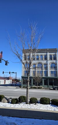

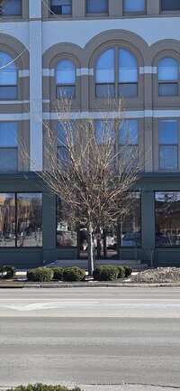

I don't have a pic before anything was done. Before pic is what it looked like when I showed up. After is what it looks like after we pruned it. I know it is not a model of young tree pruning...that was ruined before I got to it. I'm just curious to hear your thoughts.
Before:
and After

I’d say you likely did the tree a good service for the long run. Your work will prevent larger wounding in the future. We manage a few Elm cultivars in my area. There are some I met when they were very young and another I met in middle age.
With the young ones, structure is the main focus initially. I have thinned the stem count down by choosing the best attachments. Some of those cuts were choosing to retain 2 of 3 highly included leads at maybe 3” or 4” diameter. Those cuts seal quickly and actually form a wider union between the remaining leads. As the structure is formed, I still have to go in almost annually and remove the worst of the co-dominant stems in the periphery.
With the older one, it’s a never ending battle of chasing co-doms, but at a much lower frequency.
I think you got yours young enough to help steer them best in the long run, for good structure and aesthetics.
You have done wonders for that tree within two pruning cycles.
The only ‘criticism’ or ‘critique’ would be along the lines of selecting the lowest permanent branch. You know the tree and site, but I would imagine that the lower 1/2 to 2/3’s of the canopy will be removed. However that’s just my guess and the tree looks great. I’d probably go lighter, ‘more heading cuts to mark future removal cuts’ when training the response growth.

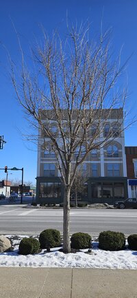

circling back around to this from last year regarding going lighter. In most cases, I might agree (though I'm getting more and more aggressive with young trees...they can take it and if its not done now, it may never happen), but I'm learning if you don't go after elm hard, you'll lose it. Just for kicks, here is side by side with where we left it last year (left) and where we found it today. I underlined a few notable branches to make it easy to compare what grew.

All good points! And great photos. In time these will be very valuable
Can’t even tell they were butchered in the past! Looks good! Those hybrid elms can take routine aggressive pruning. Hard to get central leaders on them though just because of their natural growth habits.
If the branch unions are strong, I’ve learned to accept codominants and if a branch union has some inclusion but can’t be totally removed, a hard reduction works for the time being.

I agree mostly about the inclusion reduction thing…altering the aspect ratio of the two is a good plan and the one with more photosynthetic potential can slowly swallow the lesser.
Tough thing is most Elm hybrids I’ve come across seem to form new co-doms at every dang terminal. Hard to manage without a frequent “define the lead” type of visit, in an effort to define lower structural form.
