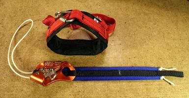

I wanted to give this method a try with materials I had on hand for use with my OnRope1 foot loop.
A heat gun was used to round and slightly flair the tubing ends.
I used Barge contact cement to glue a couple of inches of each end of the tubing into 1" tubular webbing.

Overlapped and sewed the two sections together.

And then sewed 1/2" webbing down the center leaving the ends long enough to fold back over itself to attach the CT ascender and to form an attachment loop on the foot end.

I used the same tubing and bungee as yoyoman. This bungee has a longer and strong stretch compared to common bungee cord.
A BIG THANKS to yoyoman for the excellent overall concept and bungee find.
Tried it yet?
:):):) Just did. After shortening the bungee about 3" and adding a small wiregate biner between the bottom loop and the delta quick link on the foot loop, I couldn't find anything wrong to try to improve. The biner was to turn it 90° and to lengthen it to place the ascender just above my knee.
I like this one better than my two previous attempts with the bungee attached to the top of the ascender as these do best with a bungee over the shoulder which I don't like. At 5'-8" tall, I also like it better than my regular length HAAS, which rides a little too high above my knee.
This SAKA gives me the greatest step height range I've had without an over the shoulder bungee due to the extended buried bungee (just as a HAAS) and the custom fit for my height prevents it from hitting any part of me or other gear that would shorten the step.
Me likey. Thanks again yoyoman!

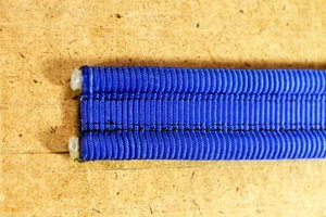

Yes, I used a cotton swab to get Barge cement inside the outer edge of the tubular webbing and on the polyethylene tubing for about 2" on each end and then clamped it all in place to dry with clothes pins. Using your method with the 3" webbing would allow more accurate adhesive placement but I 'got her done'.

After the adhesive dried, I used a zipper foot and ran a line of stitching tight against the polyethylene tubing for the full length of each piece before I sewed the two halves together.

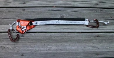

I had the idea that using a single larger diameter tube and 3/16" bungee might make for easier construction so I gave it a try. The tube was glued into 1 1/2" chafe guard and 3/4" tubular polyester webbing was sewn to that for strength and to connect the ascender and lower biner. It didn't turn out to be much easier to make and while it works OK, the two tube version works better so I will stay with that in the future unless I get any more "bright" ideas.

I'm much happier with the new foot loop I made. It works very well without the bulk of the OnRope 1 foot loop underneath that I found allows my foot to slip in some situations. the bottom is stiffened with 6000 lb webbing and I used fixed instead of adjustable elastic.

I'm finding the little D I put at the top pretty much not needed. The bungee is shortened to touch the top of the body so I just use the regular clip to hang it on my saddle.
On the foot loop, I'm also not sure if the captive eye is needed, it seems to seek it's own balance point, but on the other hand the is some stability offered with the captive eye.
