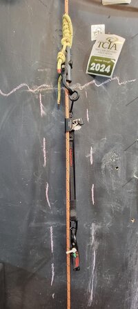

For many years I used a solid rubber core with a dyneema cover. The intent was that the dyneema has a low coefficient affection. The bungee travels inside of a tube. I was using a polyethylene tubing that was glued inside of webbing. The PE tubing is also low friction. For that reason you will find it used often on the bowden tubes for 3D printers and such.
In spite of these things , I started to notice that the bungee would start to fluff up and then in so doing would lose some of its stretch. Mind you the bungee on the SAKA has a direct path with no bends and very minimal friction but still there's a lot of movement there.

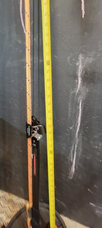

Currently I use a bungee with polyester cover and a more traditional core of numerous elastic strands. It is manufactured to my specifications and has a looser weave that allows it to have a tremendous amount of stretch. It needs to be cut with a hot knife as you can see in the picture, if it is not it will start to unravel quickly.
So one of the major advantages here is that we have plenty of stretch to take the ascender directly to the bottom of a climber's life support multiscender. This avoids having to have any components or bungee from rope walking adjacent to or above the life support device and it also avoids having any curves or bends or friction type of travel in the bungee cord.
The tubing is now LLDPE, or linear low density polyethylene.
