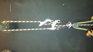

Starting to look like the modified RR.

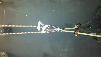

The bone still works in exactly the same way Gordon made it. The only difference is replacing the link as the bottom friction point with two independant pins which allows for increasing both the length and width of the apeture.
The look is just a rough shape to eliminate excess material And could be done more elegantly.

It works well with the 3/4" bollard and my original BDB, but with my home made bone, the upper pivot spacing is 5/16" closer and it has a lighter touch that I prefer.
It is my understanding that the newest BDB's have the upper pivot spacing 1/8" closer (1-3/8") that I suspect will have a very nice touch on the Yale 11.7's.
