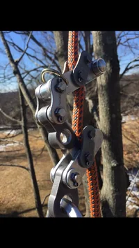

Well I've definitely got some issues to work out, tried running it today with the 5/8 bollard it came installed with on some well loved tachyon, ddrt. Would barely move, my shoulders are killing me. The top moved and released smooth, the bottom is binding badly. I could collapse the upper arm fully into the bottom and still had to almost bounce on it to descend, and that was with the rope straight down below me. I gave it about an hour before giving up and going back to a VT. It was like going from a bound up taut line hitch to a spider jack on a pulley saver. I'm baffled. I could barely get the rope out of the bottom arm when uninstalling it.
Has nothing to do with ddrt vs srt I'm sure, even trying to feed out slack on the ground to set my line in the tree took both hands and way too much force.
Jeff, are you running the Bone DdRT with the standing side of the line directly back to the Bridge? If so then it sounds like the bottom arms need to be milled out wider too accomodate your tachyon. Send it back and I will tweak it for you if you like.

Yes, I had the standing end of line back to the bridge. I'm gonna toy with it a bit tonight and see what I come up with, ill be climbing all day tomorrow so I'll be able to at least field test it in short order.
Gordon
Any idea what the cause/effect would be, so I have some idea what to look for? These ran so smooth on the show floor at New England Grows, was baffling to have it be the complete opposite end of the spectrum running it on a slightly fuzzed rope.

Jeff it is frustrating. The only thing I can think of that may be different is the rope itself and the tolerance of the gap between the inner arms of the Bone. The tolerance is rather tight on the Bone and even 1/16" can make a marked difference. Also the new bones have a small groove in the spine to ease the gap there. Send it back and I will tweak it. I want you to have a good useful tool.

Tends UP very smooth this way, aa well as using the tether ddrt. Just having issues on the descent. It's markedly better srt, and I may have run a fine file over the backbone as there were still some evident tool marks from machining where the rope ran, seem improved. I'll give it a go tomorrow, both srt and ddrt, if still no signs of improvement, it'll be in the mail and Gordon can play with it.
