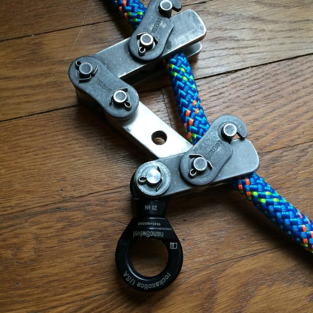

Hey Steve, I hope u enjoyed your first bone samich. Here's a close-up of the nano/bone combo.

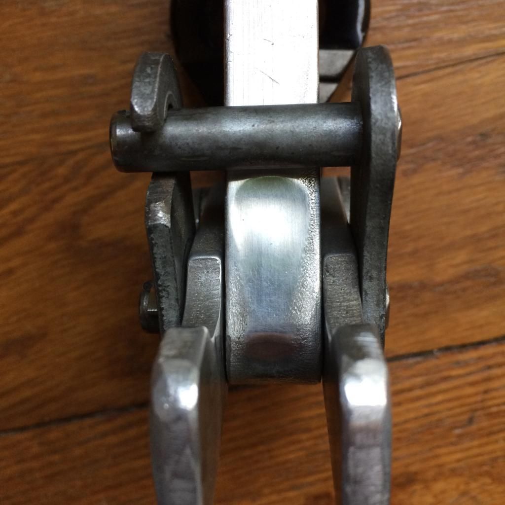

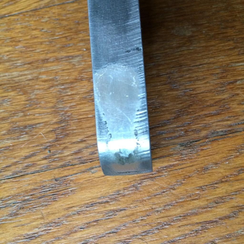

Here's some photos of the ware and tear on the spine. Haven't notice any on the links or bollard. I switched spines about a month ago but not due to ware.

Why do you prefer to attach the nano swivel directly to the bone instead of having a swivel on the bridge? I'm sure it's been discussed before but it's too much to read again. :) Is it to get the friction system closer to the harness? I've been thinking of attaching a smaller carabiner (DMM Shadow) directly to the bridge and wear that one out and have a nano swivel on the bone. Now I've got a DMM small swivel on my bridge.
Aluminium is really soft. The 7075 should take wear a lot better. I've got a few titanium pieces laying around... maybe I should get them to the water jet cutter and make a spine. :)
