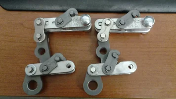

Jimmy do you have a picture of your dog? I know there are a few variations out there and I am not sure what yours looks like. It may help us narrow down your drag issue on ascent.
I will give it a shot Monday with the smaller bollard, Im using Tachyon with the CE colors , also I use a chest harness as well.
Do you the long original pivot up top or do you have the shortened version similar to the lower arms. Are you tending from the upper spot or from the spine? Sorry for the questions if someone has already asked them.
These are mine Jimmy and they both tended well despite the different pivot points. I have them both set to match the version on the right but as far as the tending goes...you might try drilling holes or tieing a loop first closer to the open link. Just a thought, I'm sure Eric and others will chime in if their opinions differ.
As long as the upper arms remain up, while ascending, the position of the tending hole is not the problem. Eric touched on something important. If there is something pulling down on the BDBs carabiner while you are going up it will engage the lower gripping components, causing drag.
