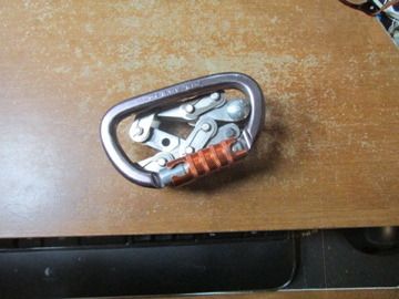

lanyard bone for 10mm rope. Nickel plated links and SS arms. Notice the bollard axle at the end of the bottom arm, this can be done on the stock Bone also with a slick pin, to ease slack tending.
Couldn't you climb with that as your primary system? I would like to hear Erics thoughts and experience using that as is secondary. It would be pretty neat to see Eric climb DSRT with two bones and the mini bone (wink wink;):sisi:). I think the name "pitbull" bone fits.

On another note, The Bone will release with the bottom arm, just as well as the top arm, all you need is a long enough arm at the bottom to gain the mechanical advantage. I have made a 5" long extension handle on the bottom arm that is easy to add/remove with one slick pin. As you pull down on the extension handle, the top arm swings upward even more as the load is transferred to the top arm. I think a recreational climber, might really enjoy this mode of release.
To make it hold on 10mm - did you move the pivot on the upper arm further out?
I recently made my own 2nd-bone to play with the top arm. I found that extending the top and bottom pivots slightly made it work beautifully with my 11mm rope - although it doesnt tend quite so smoothly of course.
No, in fact the upper pivot length is 1-1/8" (the lower pivot length is only 3/4"). The spacing between the arms (and the bollard-friction link pin) is on the order of 11mm. Also the pin dia. is only 6mm.
Here it is in a collapsed form. 9 oz.
