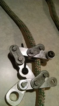

Shortened both arms. It is easy to operate the bone this way with both hands for me. The link on the lower arm acts as nubs and won't let the arms touch or cross load.
This is something that I thought could have been done. Thanks for being the first to actually do it. Keep is all posted about how it works as time goes by.
I'm interested to see if moving the pivot point of the upper arm (like some have done for thicker ropes) makes a good compliment or your mod. If the pivot relocation makes it easier to release and control the Bone, I can really see the shorter arms working.
Right now (prolly due to my weight), I like the leverage I have with the arms at stock length.

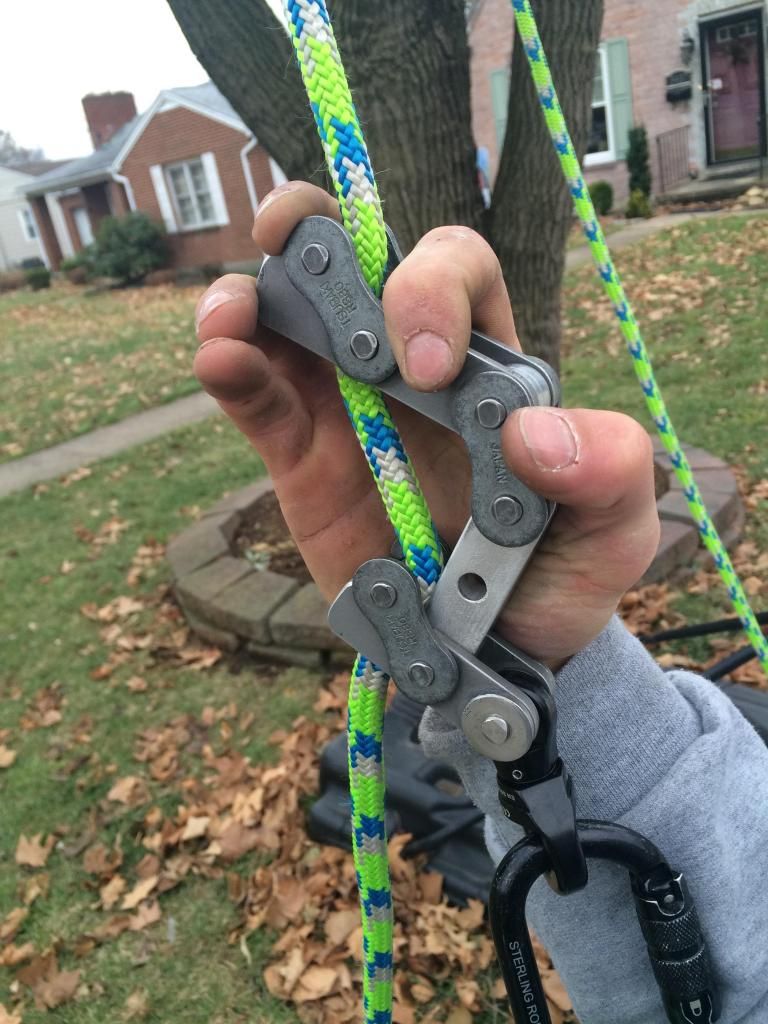

Do it up . Be a legend in your own mind! Between your new chest harness idea and little tending tether idea from mikepowers. In combo with all tending thoughts on static vs. bungee . I'm trying this little bungee loop tether . Any thoughts?
...Any thoughts?
It will stretch 3" and then become static.;)
FWIW, using Mike's first tether location through the center of the upper link and a static tether, I have not been able to keep the BDB from grabbing as I was able to do when tethered off the back of the tether hole...and I have tried repeatedly with different rope, bollard and even custom top arm configurations.
Aaron, I think that could work nicely. I just want to understand why...Is it sort of a variation on Mike's tending idea without concern of the ring preventing the top arms from engaging?
I didn't even think about a ring at all . Just looking for a little give as I'm moving. Didn't put a whole lot of thought into why , just sorta spawned after I put a chest harness together . I've always thrown a lanyard over shoulder and its got no give . and a bit more cumbersome I believe . So I'm just giving this a try . Semi Static over the bone instead of no give. I'm not a fan of neck tethers bungee or other wise . The tree climbers belts turned chest harness is what brought it together for me . Just was in my shed grabbing a little biner to finish the harness and the bungee started staring at me and there you have it!
The first statement you almost stooped to my level ;) Then you came back to help ! Thanks for the info Reed.
i tried mikes config today and it didn't tend very nicely for me. I was using a static neck tether. Would a bungi neck tether fix the problem??
What if... where ur chest harness comes together in the front, u girth hitch it together with some bungee and a biner if that makes sense.
It didn't even think about a ring at all . Just looking for a little give as I'm moving. Didn't put a whole lot of thought into why , just sorta spawned after I put a chest harness together . I've always thrown a lanyard over shoulder and its got no give . and a bit more cumbersome I believe . So I'm just giving this a try . Semi Static over the bone instead of no give. I'm not a fan of neck tethers bungee or other wise . The tree climbers belts turned chest harness is what brought it together for me . Just was in my shed grabbing a little biner to finish the harness and the bungee started staring at me and there you have it!
You know, sometimes the bit of kit just lying around serve as great ingredients for new projects. Give it a go and let us know! I only thought of the ring as a means of not allowing the bungee loop to fall down inside the ingenious mechanismic awesomeness of the Bone's internals.
