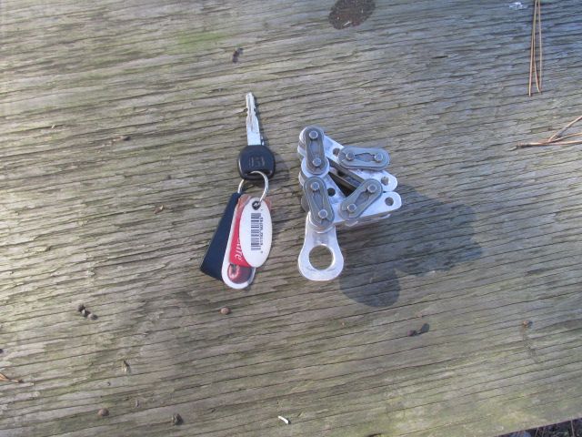

Compact Bulldog Bone
Sorry about that oldoakman!, but this one is intended for 10mm rope as a possible lanyard adjuster.
I switched my tending spot once again. This new spot on the bone tends like an absolute dream on yale luna....and I am very happy with it. The previous position helped truly, but I was not fully satisfied.
As a test, I leaned back on my neck bungee once again with excessive force and the bulldog would not budge. I tried a static neck tether on this and played the unconscious game, with still no budging at all. If you really pull down very hard with the static neck tether it will release, like if a six inch limb fell forcibly on your static neck tether or something. I will be sticking with the neck bungee for sure. I have been playing with it for the past few hours outside, and I was super happy.
Once again, thanks Gordon!

That is Sweet Mike! This would likely torque the upper arm onto the rope, helping to keep the top arm engaged, as you lay back. Bungee is good also.
There is a caution there however, as you do not want the the upper arm to be constrained from its upward free motion when weighted.
Tyler, the cross load danger would be as you are snubbed up relatively tight to the tree.
How are you finding the Nano Swivel working with the Bone?
Works pretty good! Just a wee bit longer than the stock tear drop but that's not a big deal to me. I Like it better on the bone then my bridge cause I have a lot more room to connect stuff on my bridge ring.

Tyler, the cross load danger would be as you are snubbed up relatively tight to the treee.
I just wanted to point out that with the upper arm shortened that when installed on a rope that the arms are short enough that the lower link won't allow the arms to cross load. And the arms aren't long enough to cross.
Tyler, how does that feel with less leverage to operate?
